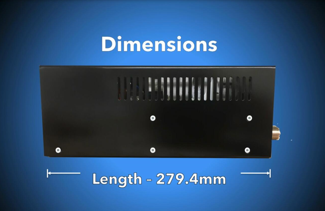

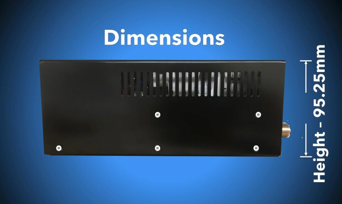

Weight Model specific, approximately 3Kgs
Dimensions 95.25mm (H) x 127mm (W) x 279.4mm (D)
